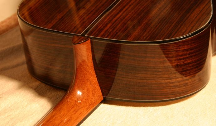

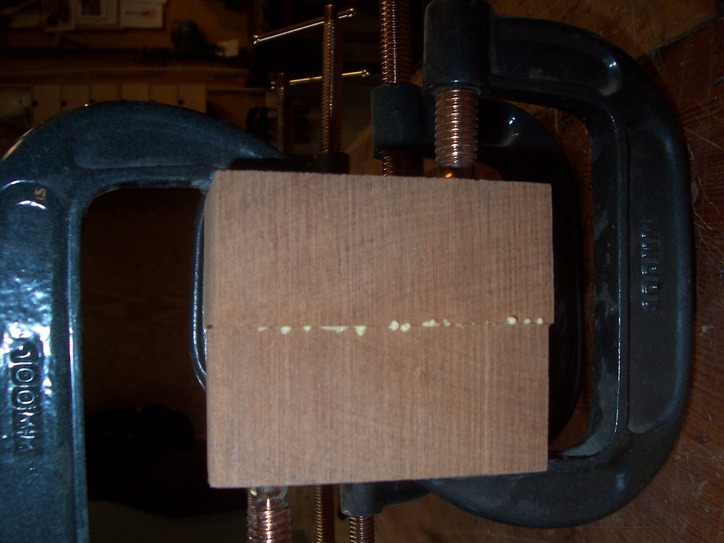

Mahogany is very stable, the neck will be fine. However, if a one piece neck is not quartered the figure will be asymmetrical, most noticeable in the heel and headstock regions. I like to orient the growth rings in two piece necks like so \\\///; in theory it should be stronger, and the heel looks better IMO.
...and here is the finished neck from the glue up above. Well, the picture does not really show it, but the lines on both sides of the heel converge at its center line, so it looks book matched (even though the it is not).
PostPosted: Sun Apr 29, 2007 12:10 pm
Oooow, that's very pretty Arnt.
PostPosted: Sun Apr 29, 2007 12:26 pm
I like that Arnt. Thanks for the pictures.
